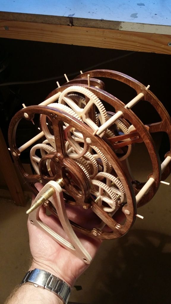

Postby minimoa69 » Mon Sep 26, 2016 11:13 pm
So, where the heck did the last year go? I've been quietly beavering away on my machine over the past 11 or 12 months, refining the design a bit, and cutting out all the bits for MK2, which I'm now happy to say is finally being assembled. It's been a very long road, but hopefully I'm getting to close finishing it before I reach old age...
I'll try and post more frequent updates now that there's actuality something worth sharing!
Photos show new all the components cut and ready for assembly, first gears being fitted to the main frame, the planet unit freshly completed, and the new frame design.

Postby minimoa69 » Mon Oct 24, 2016 11:02 pm
Not finished by a long shot - but it's now in more or less one piece and it works! Happiness is 57 spinning wooden gears. Almost ready to start predicting an eclipse or two!
