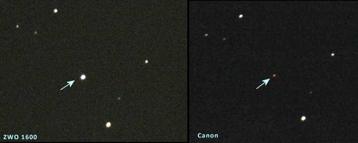

Postby Aratus » Tue Dec 04, 2018 12:40 am
Graeme1858 wrote:Is it clear enough to get an update tonight up your way?
It was clear enough, although still murky near the horizon.
What I can report is that the fuzz is still there on the ZWO 1600/80mm refractor. It isn't an artifact on the sensor as I tried it in different places.
I then tried to find the same star on the Canon/11"SCT. There is no fuzz around the star, but the star is very dim red star.
The obvious thing to do then was to connect the ZWO 1600 to the 11". This involved a lot of messing around changing the focus, and the alignment decided to go haywire. :x Anyway eventually I got it. The result of that combination was that there was no fuzz - much to my disappointment. However, neither was the star a dim red one. With the ZWO it was as bright as its neighbours! :o
I've combined the images to roughly the same scale on this image.
I suspect the difference is due to the different internal filters used on the 2 different cameras. The star is clearly giving off light of a particular frequency which the ZWO filters let through, but the Canon doesn't. None of this explains the 'fuzz', but possibly it is part of the same phenomenon.
btw the star is designated as USNO J0231578-193055
I'm not sure where we go from here!
If anyone else would like to image this star with their equipment, it might help.
The J(now) co-ordinates are. . .
RA 2hr 32m 49.5s
Dec -19 26' 04s''
You should be able to put them manually into a 'goto' telescope mount.
Aratus
