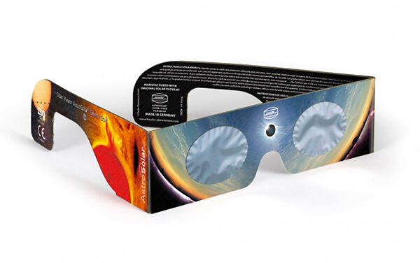

If you want to use solar eclipse glasses to observe a solar eclipse, you need to make sure they are properly certified and safe to use.
Solar eclipse glasses use solar filters. These filter sunlight, enabling safe observation of the Sun.

Safe solar eclipse glasses block all but a small portion of the Sun’s ultraviolet, visible and infrared light, preventing damage to eyesight.
Solar filters that provide safe views of the Sun generally transmit between 1 part in 100,000 (0.001%) and 1 part in 2,000,000 (0.00005%) of its visible light.
Look for the International Organization for Standardization (ISO) mark, the ISO 12312-2 standard for filters for direct observation of the Sun.
Beware false certification! Check for a manufacturer's report showing compliance with ISO 12312-2 based on tests at an accredited laboratory.

Can you use old eclipse glasses?
Given the dangers of looking at the Sun without proper protection, it's not advisable to use very old solar eclipse glasses, but provided your solar eclipse glasses are only a few years old, they should be safe to use.
But you must still check them for bends, warping, tears, scratches and pinholes, even if they've been sitting in a drawer since they were last used.
Hold them up to a light bulb and see if you can spot any light passing through. If you see light coming through, you can't use them.
If your solar eclipse glasses are 10 or more years old, you should ideally get yourself a brand new pair.
Manufacturing standards and the materials used in making certified solar eclipse glasses have changed in that time, so it's not advisable to use models bought a decade or more ago.
The American Astronomical Society says "If your eclipse glasses or viewers are less than 10 years old; if their manufacturer has had them tested by a properly accredited laboratory that has found them to conform to the ISO 12312-2 standard; and if their solar filters aren't scratched, punctured, torn, coming loose from the frame, or otherwise damaged, you may reuse them."
