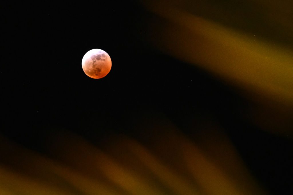

Lunar eclipse Emmanuel Delgadillo, Jalisco, Mexico, 3 March 2026 Equipment: ZWO ASI2600MC Pro camera, Canon 500mm lens, Celestron CGEM mount
Lunar eclipse by Emmanuel Delgadillo, Jalisco, Mexico, 3 March 2026. Equipment: ZWO ASI2600MC Pro camera, Canon 500mm lens, Celestron CGEM mount

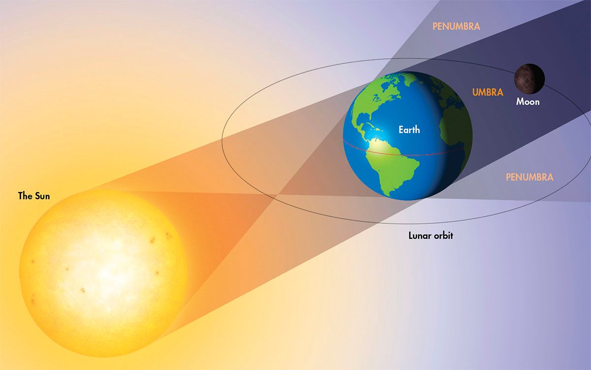

A lunar eclipse occurs when the full Moon passes into the shadow that Earth casts in space.
Despite the shadow being quite large at the distance of the Moon, the 5º inclination of the Moon’s orbit relative to that of Earth means that most full Moons miss the shadow completely.
They simply pass above it or below it.
Lunar eclipses occur when the Moon passes into the shadow that Earth casts in space. Credit: Pete Lawrence
The shape of this shadow is determined by the Sun appearing to us as a circular extended light source, with a diameter of 0.5º.
This creates a shadow of two parts:
  • A dark central portion called the umbra
  • A less intense portion called the penumbra
As the Moon moves deeper into Earth’s penumbral shadow, it appears as though a dark bite is being taken out of the Moon. Credit: Pete Lawrence
As the Moon moves deeper into Earth’s penumbral shadow, it appears as though a dark bite is being taken out of the Moon, as you can see in the top left here. Credit: Pete Lawrence
If you piloted a spacecraft into the umbra, the Sun’s disc would be completely hidden behind the Earth, but inside the penumbra only part of the Sun’s disc would be hidden.
Entering the penumbra would result in a drop in light levels, which would become more noticeable as you moved towards the umbra.
If Earth were airless, the umbra would be really dark.
However, Earth’s atmosphere refracts sunlight and this partially illuminates the umbra.
This light is from the red end of the spectrum – shorter wavelengths in the blue region get scattered – so the umbral shadow appears reddish in colour, essentially illuminated by a circle of sunsets and sunrises.

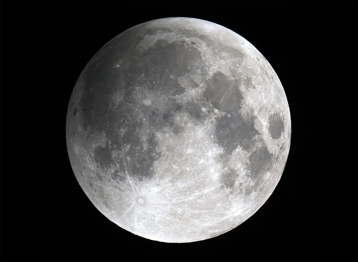

As the leading edge of the Moon enters the penumbral shadow, the penumbra tends to be very weak, and at its outer extremes you are not likely to be notice this transition.
As the Moon passes towards the umbra, the amount of light it receives decreases.
By taking correctly exposed photographs of the Moon’s disc at regular intervals – say a minute or two apart – and animating them, this gradual darkening of the penumbra can be revealed.

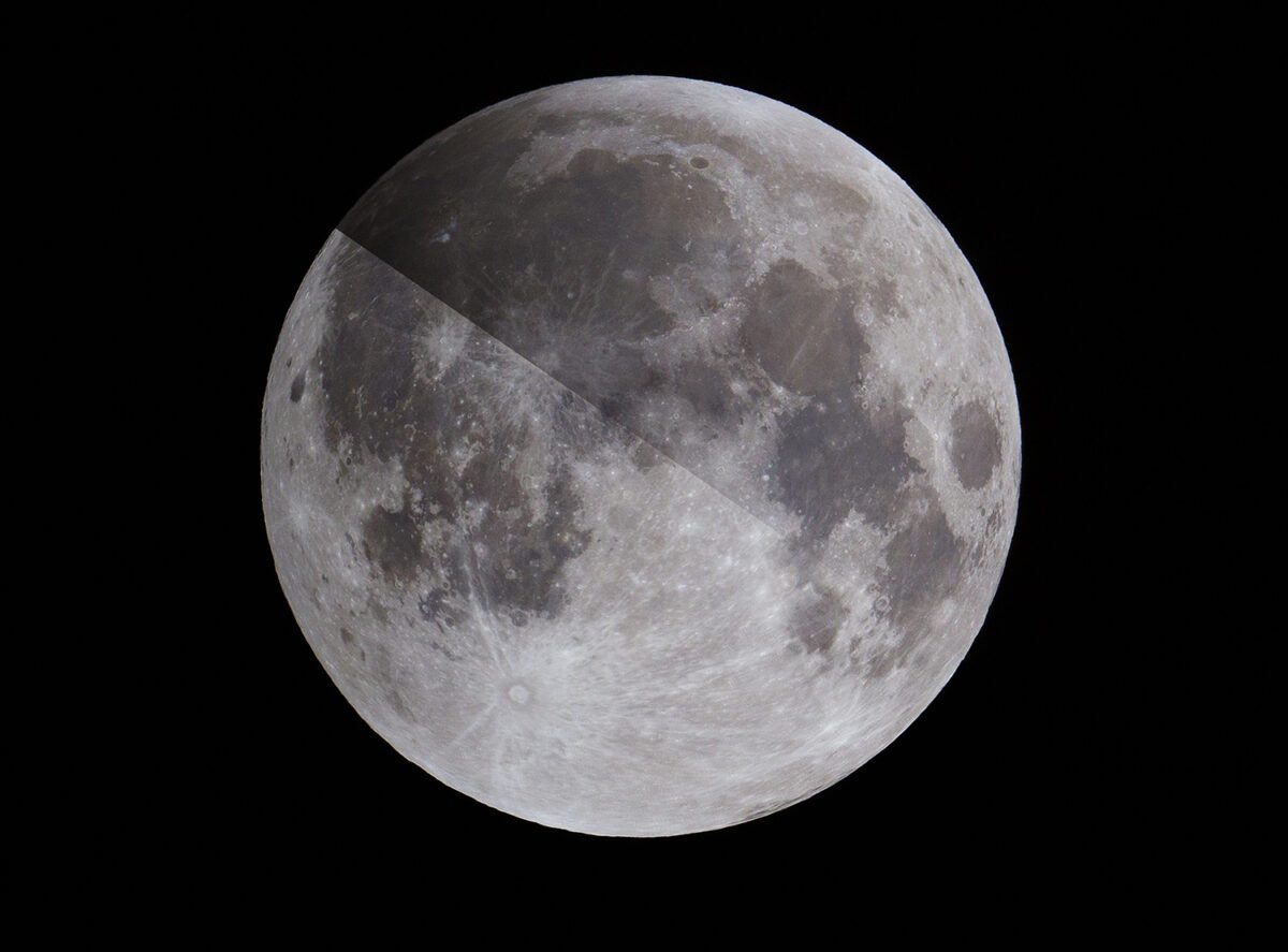

The penumbra is about 0.5º wide, similar to the apparent diameter of the Moon. It takes the Moon just less than an hour to cross it.
After first contact, the umbral partial phase begins.
The visual appearance of the Moon looks quite odd after first contact, almost as if something’s taking a melting bite out of it.
Expose a photo for the bright portion of the Moon’s disc and the umbral shadow will appear dark, without features.
If you increase the exposure red-hued detail will appear inside the shadow, but the bright surface will become overexposed.

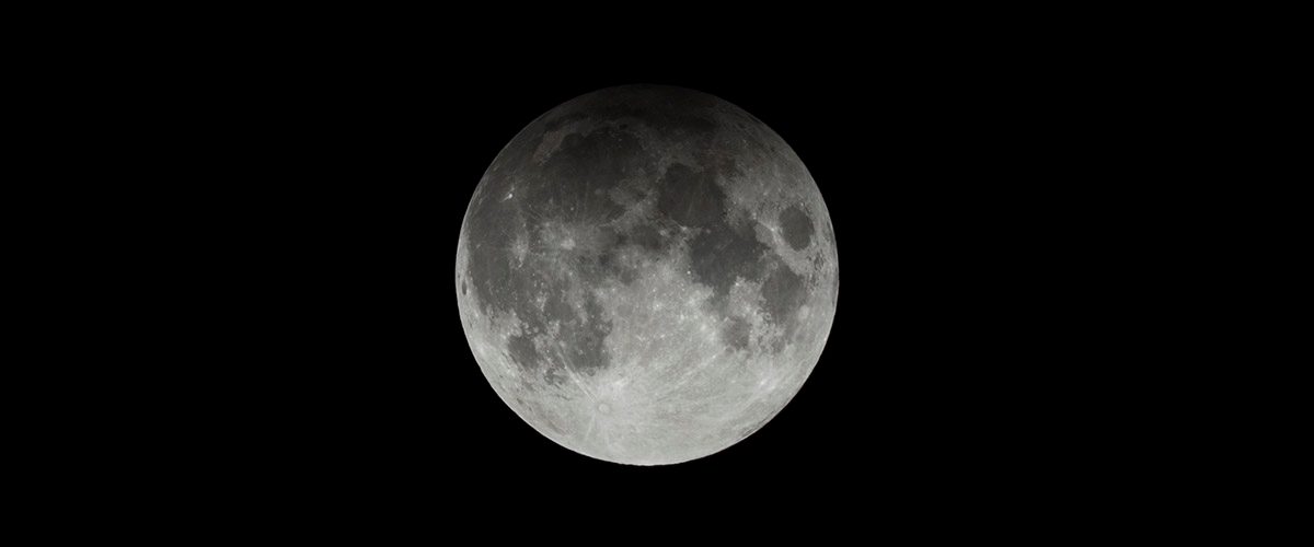

See a partial lunar eclipse in the UK this weekend, 28 October 2023. Credit: Jacek Kadaj / Getty Images
Partial phase of a lunar eclipse. Credit: Jacek Kadaj / Getty Images

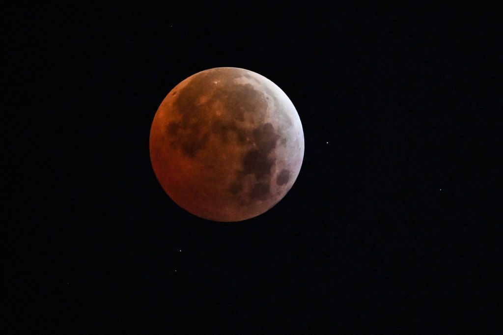

A low ISO of 200-400 is ideal to photograph the partial phase of a lunar eclipse.
And a lens with a focal length of 100mm will produce a recognisably eclipsed disc, but a 1,000mm focal length lens will really bring out some stunning detail.
A low ISO will also result in a better tonal range. This is really important for the edge of the umbra, where the colours can be glorious.
The umbra itself may appear anything from a golden orange to a deep blood red.
At the edge, subtle yellows and grey-blue bands may be recorded.
The blue seen here is due to light refracting through the Earth’s ozone layer; in this case it’s the red light that gets scattered, leaving blue to pass through.
The last portion of the Moon’s disc to darken will be that close to the southeast limb.

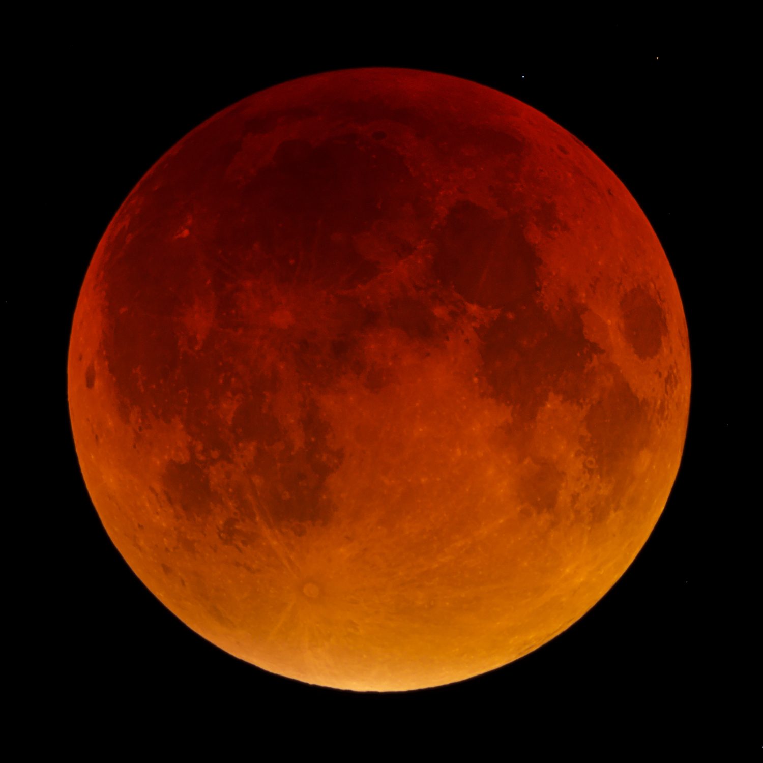

Totality, as it is known, is easier to deal with photographically as there’s no bright surface visible to overexpose.
The exact colour and darkness of totality isn’t easy to predict.
Some are very dark with the Moon virtually disappearing from view.
Others are light, showing a golden-yellow colour. The variation means that reviewing camera feedback is really important to get the exposure right.

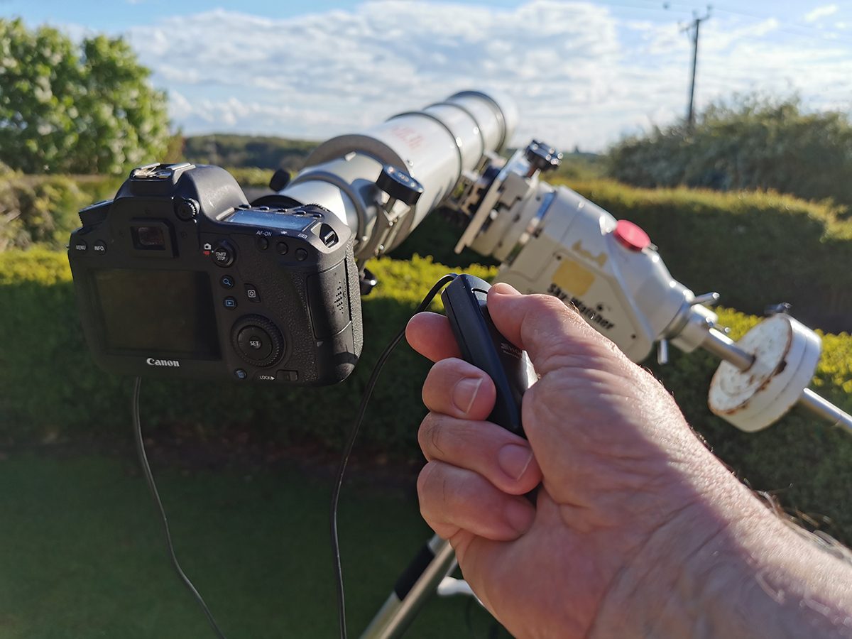

Keeping the lens aperture wide and exposure short will alleviate problems caused by the Moon’s movement or from wind shake.
A fixed tripod is great but a driven equatorial mount makes life easier, especially for the longer exposures needed during the totality.
A remote shutter release will alleviate shakes caused by physically having to press the shutter button.
A remote shutter release helps to avoid camera shakes when you photograph a lunar eclipse.

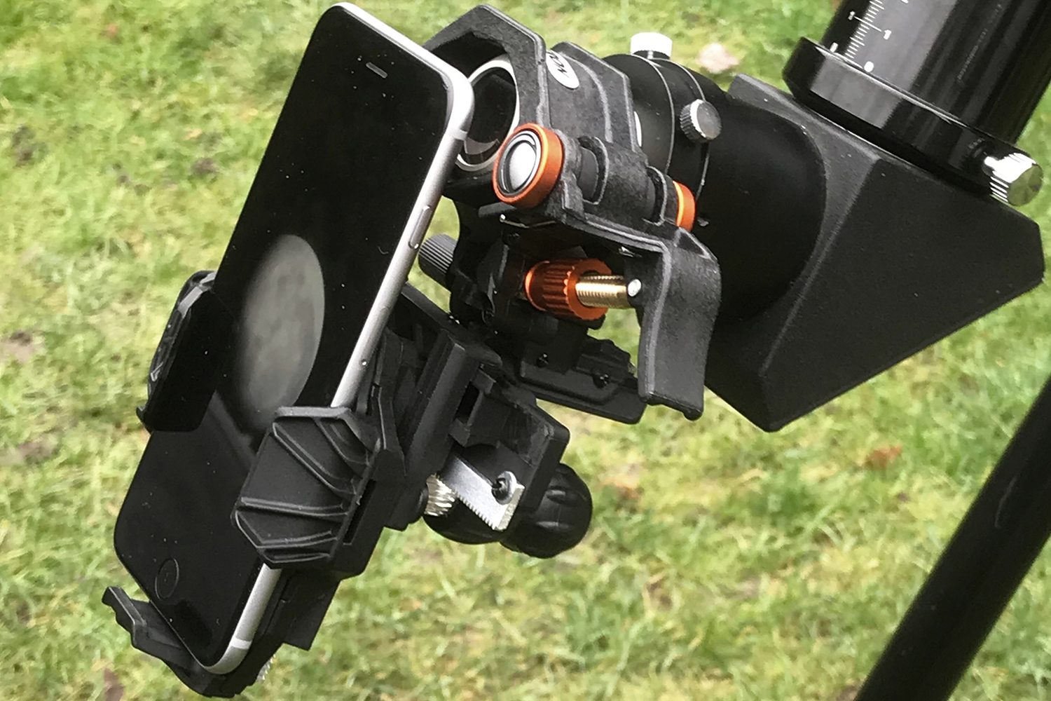

You can photograph a lunar eclipse with a smartphone by pointing the phone down the eyepiece of a telescope.
A low- or medium-power eyepiece works best, though you’ll also need a steady hand to line everything up.
Start by holding the phone some distance away from the eyepiece and gradually bringing it closer, while guiding using the phone’s screen.
Or, you could use a smartphone telescope adapter.
A smartphone telescope adapter will help you line up your phone's camera with your telescope's eyepiece

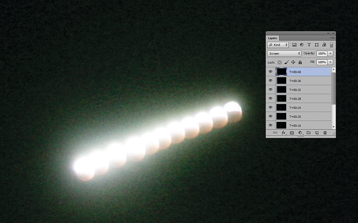

A wide-field camera on a fixed tripod can produce a stunning photograph of a lunar eclipse sequence.
Use a low ISO of 200-400 and expose so the full Moon appears bright to the point of being almost overexposed.
Take shots at regular intervals, say four minutes apart.
Load each image into a layer-based editor and draw a circular selection around the Moon with 2-5 pixel feathered edges.
Invert the selection, create a new layer above and fill with black.
A sequence shot of the 10 December 2011 lunar eclipse, by Tim Jukes, Tsukuba, Japan. Equipment: Nikon D7000, Sigma 100-300mm f4 + 1.4x Teleconverter.
Save these Moon-only shots with a sequence number – for example 001.jpg, 002.jpg and so on.
Load each Moon-only image into a separate upper layer with blend mode set to Lighten.
Merge with the layer below.
Pick an original image with a good sky and load as the top layer; set its blend mode to Lighten too.
