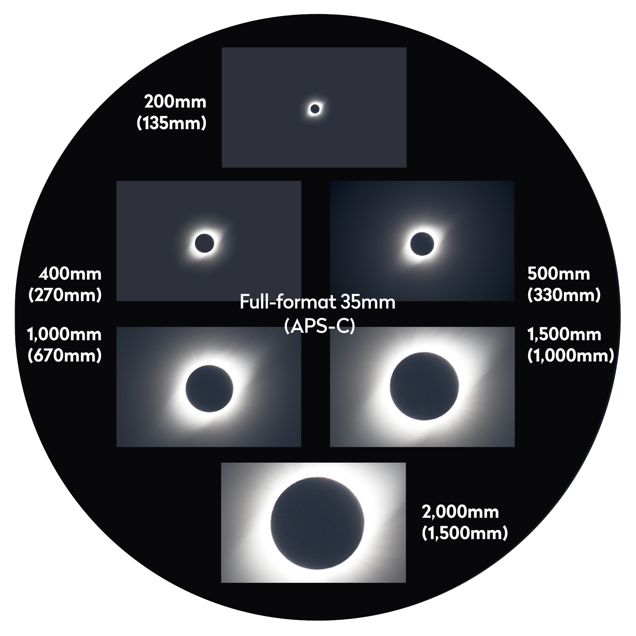

Lens focal length dictates image scale: a long focal length gets you close in on the eclipse, but it means you’ll have to keep everything centred.
It also restricts coverage of peripheral sky targets such as stars, planets and the solar corona.
A short-focal-length, wide-angle lens allows you to capture the bigger picture, but if it’s too wide it will produce a rather tiny eclipsed Sun.
When photographing a solar eclipse, you could choose a setup that enables you to capture the wider picture, including fellow eclipse chasers in the foreground. Photo by Natalie Behring/Getty Images

How a solar eclipse will appear depending on the focal length of the lens you choose. Credit: Pete Lawrence

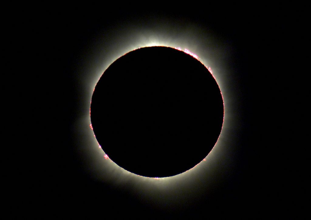

  • For Baily's beads: 1/4,000s

Baily's beads are a great feature to capture in your photograph of a solar eclipse. Photo by TORSTEN BLACKWOOD/AFP via Getty Images

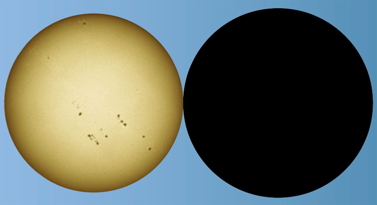

First contact
solar eclipse first contact
Make sure your solar filter is fitted (it can only come off for totality) and your exposure set correctly as the show begins

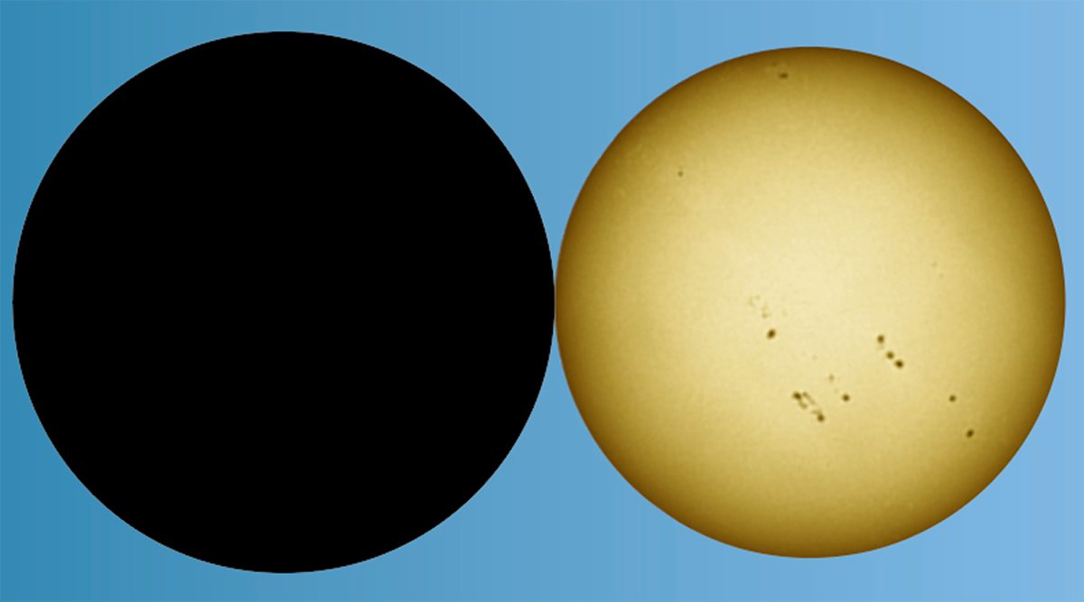

Fourth contact
solar eclipse fourth contact
After the Moon’s last moment of contact with the Sun, full daylight returns. The show is over

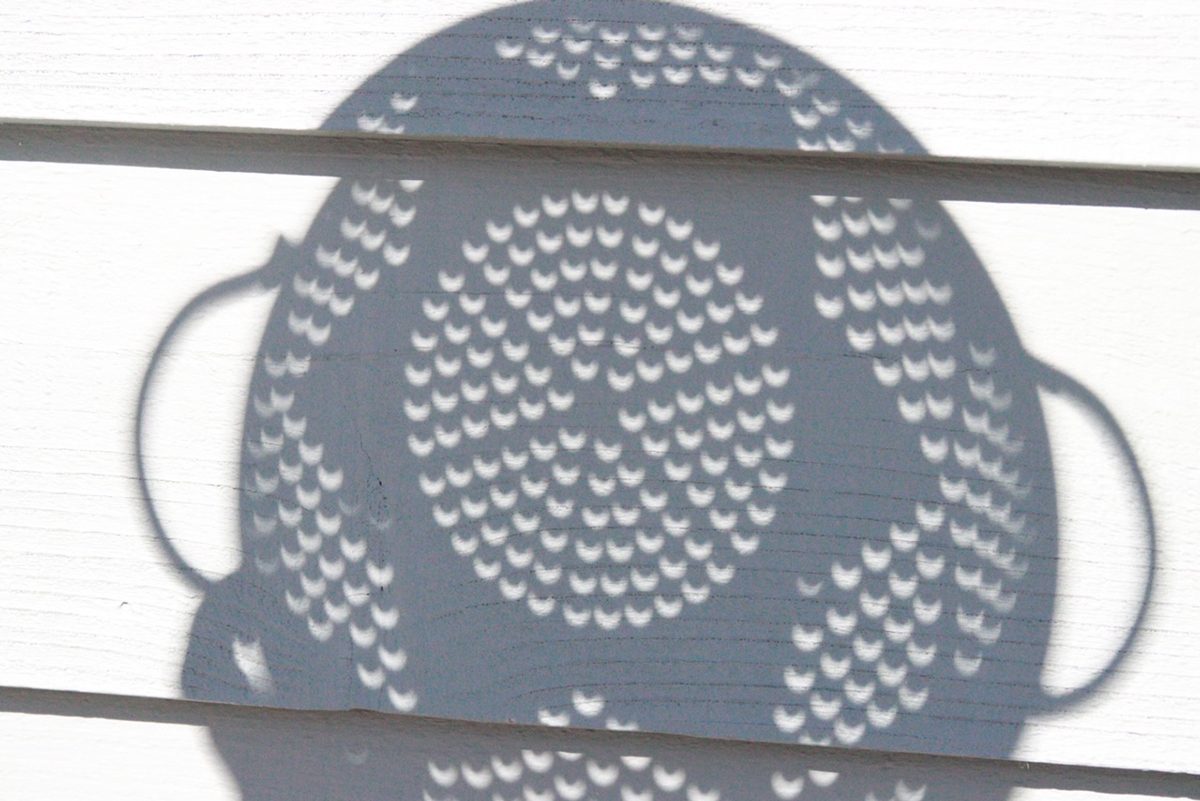

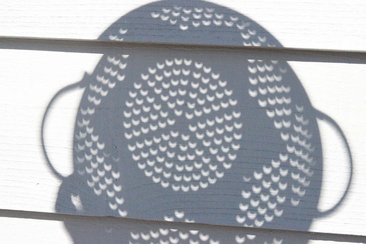

A popular image to capture during the latter stages of the initial partial phase (or during the second partial phase, if you miss it the first time!) involves a piece of card or an object with one or more 1–2mm holes in it.
This is used to cast a shadow onto a piece of white card, each hole producing a tiny eclipsed Sun image.
Colanders and tea strainers are ideal for this, and you can find out more about these techniques in our guide on how to safely observe a solar eclipse.
The 14 October 2023 annular solar eclipse captured through a kitchen colander by Donald Samuels from Colorado, USA.

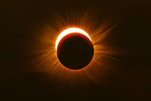

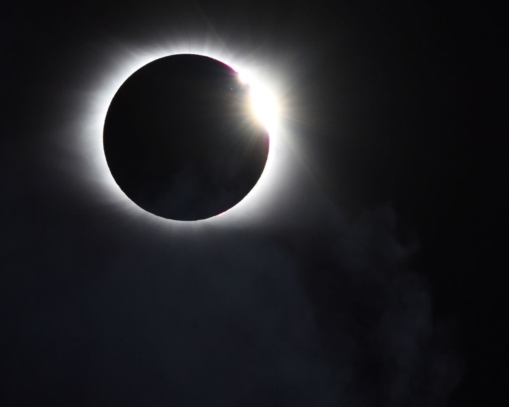

Capturing the diamond ring effect in your solar eclipse photograph may make for a more spectacular image than full totality. Credit: Chris McKay / Getty Images
Baily's beads and diamond ring
As we approach totality, the cusps of the Sun’s crescent close strikingly fast.
As they do, tiny star-like points called Baily’s beads appear where the Moon’s rough edge allows sunlight to pass.
As totality approaches (or ends), it may also be possible to see the approaching and receding shadow in the clouds and on the ground, especially if you’re viewing from an elevated position.
This is subtle, but can be photographed by capturing a large swathe of the sky.
As the beads disappear, the largest produces an intense light, the ‘diamond’ in the famous ‘diamond ring’ effect.
The solar filter needs to come off from just before the appearance of the first diamond ring; remember to replace it just after the second, at the end of totality.

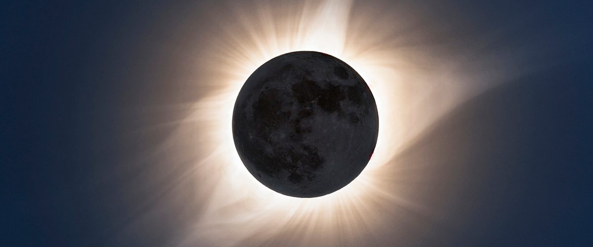

As the Moon totally hides the Sun’s photosphere, solar prominences may be seen projecting off the edge of the Sun.
These have an exquisite deep red-pink colour that may be seen visually as well – don’t forget to look!
After the first ‘diamond ring’ fades, also look out for the arc of red-pink light from the solar chromosphere.
This doesn’t last long, but it can also be caught at the end of totality. During totality, no part of the Sun’s surface is visible and this is when the corona can be seen and photographed.
Corona in 2016 Totality by Li-Chun Chen, Sulawesi, Indonesia. Equipment: Mizar FA-80 Fluorite Refractor, Nikon D800 modded,iOptron ZEQ 25 EQ.
Total solar eclipse and corona in 2016 by Li-Chun Chen, Sulawesi, Indonesia. Equipment: Mizar FA-80 Fluorite Refractor, Nikon D800, iOptron ZEQ 25 EQ.
Capturing the corona
The Sun’s corona can extend from the Sun for many solar radii.
A shorter focal length, offering mid- or wide-angle photographic coverage, is recommended to capture it.
As a total solar eclipse occurs near solar maximum, when solar activity is heightened, expect the corona to surround the eclipsed Sun like the petals of a flower.
Near solar minimum it has a more linear appearance.

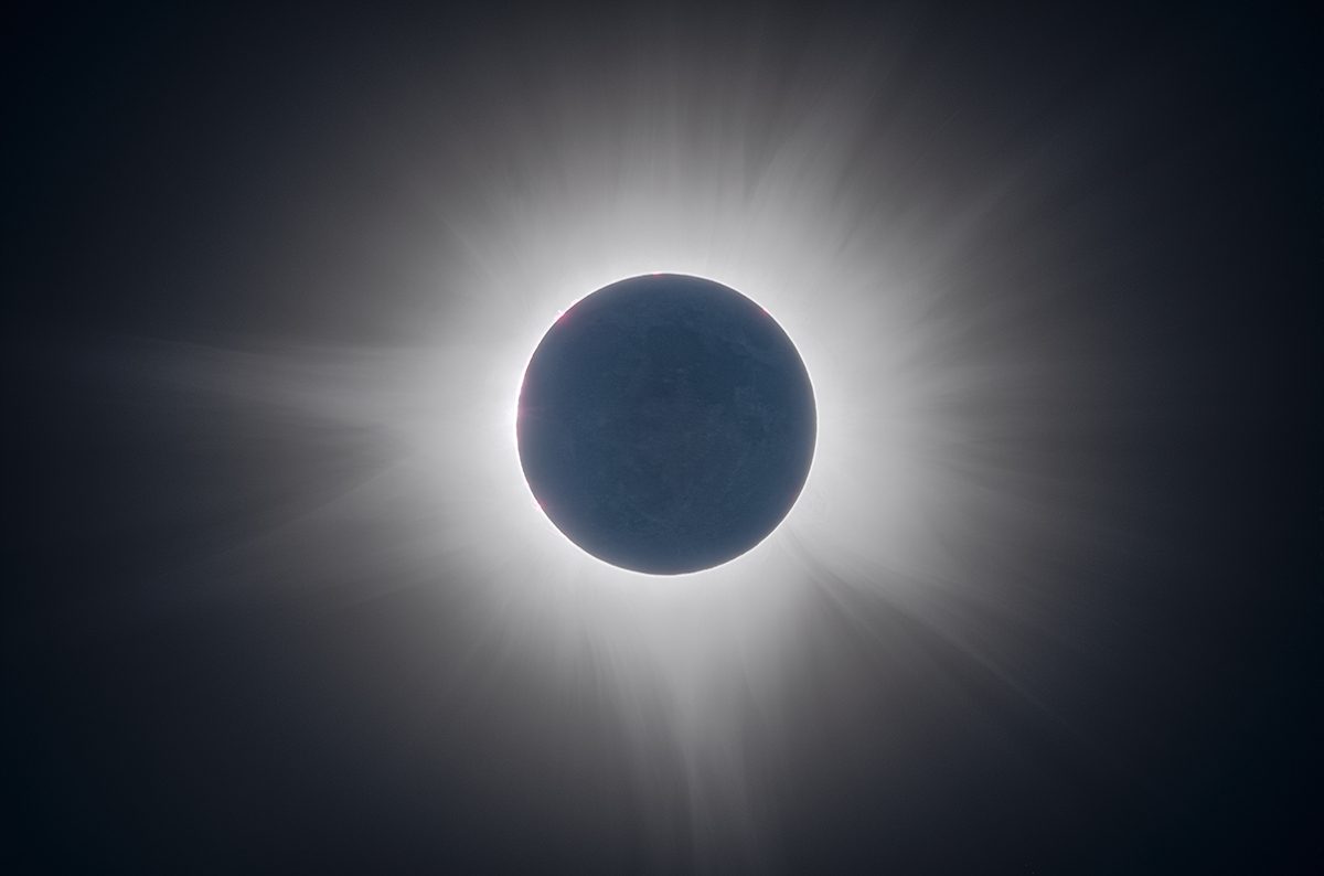

Bracketed exposures, where you take a range of exposures in succession, are recommended for capturing the corona.
Use shorter exposures for the inner corona and longer ones of up to several seconds for the long outer streamers.
A longer exposure may reveal detail on the Moon’s disc due to ‘earthshine’, when the Moon’s night side is illuminated by the light of Earth.
Earthshine during the April 8 total solar eclipse, captured with several long and short exposures by Harley Grady, Hillsboro, Texas, USA. Equipment: TS Optics CF APO 90mm refractor, Fuji XH2 mirroless camera.
By using high-dynamic-range composition techniques, for example layer masking, you could merge the bright inner corona with fainter outer streamers.
This involves opening the different corona exposures as separate layers in a layer-based editor such as Photoshop, with the shortest exposures at the bottom.
Align all images, hiding all but the lower two layers.
Create a blurred layer mask in the upper visible layer to reveal correctly exposed detail from the lower layer.
Once done, make the next layer up in the stack visible and repeat.
