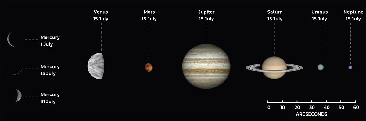

The phase and relative sizes of the planets in July 2025. Each planet is shown with south at the top, to show its orientation through a telescope
